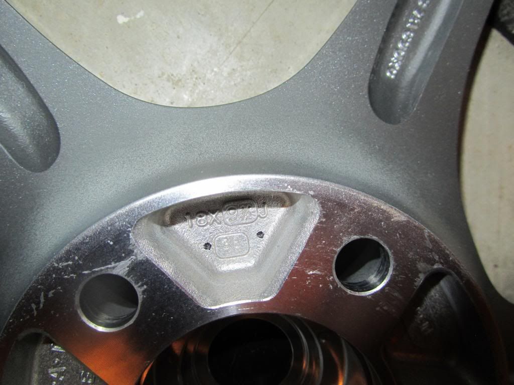

Sizes:
Wheels -
Fr 18 x 8.5 +30mm offset
Rr 18 x 9.5 +38mm offset
Tires-
Fr 235/40r18
Rr 265/35r18

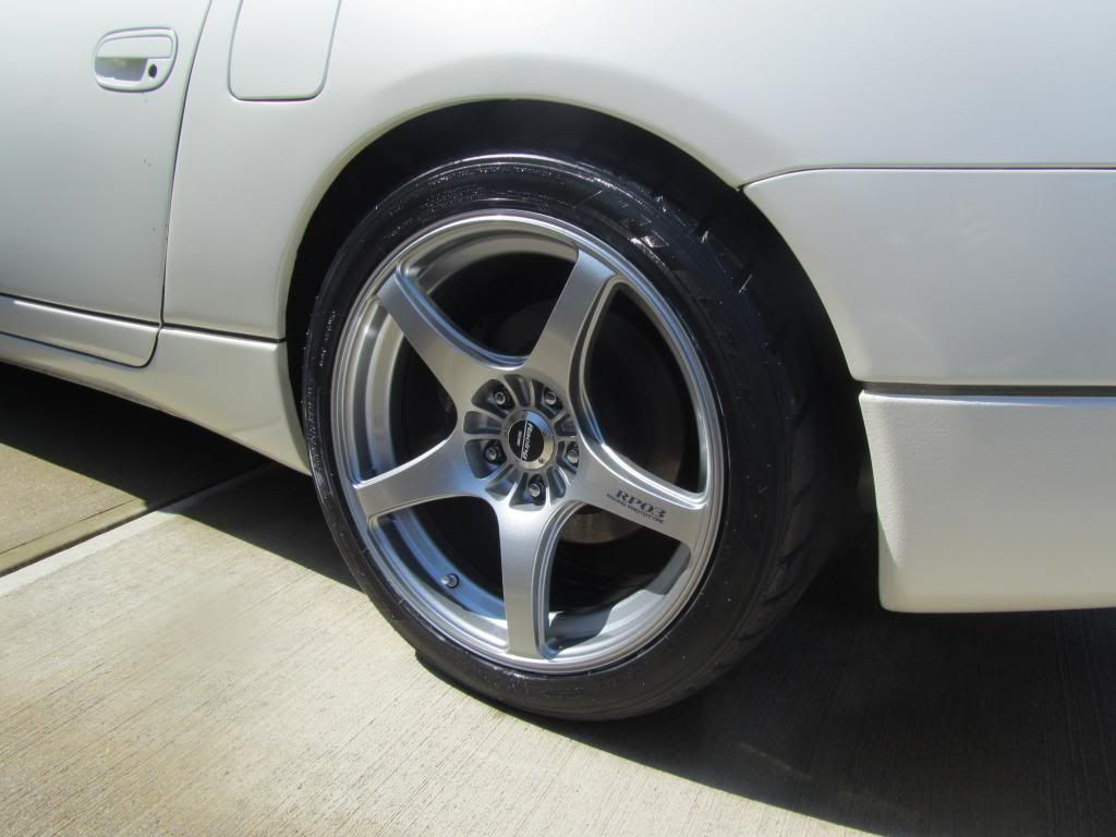

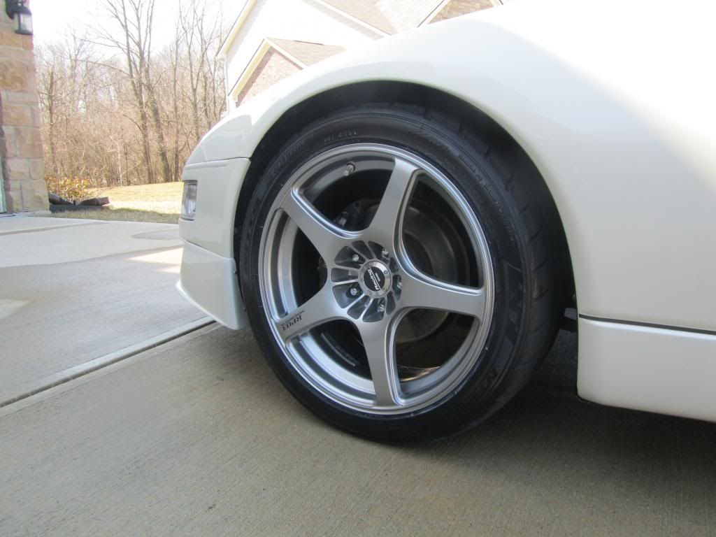

Wheel sizes selected to avoid rubbing on suspension components and fenders (front and rear) while trying to get wider wheels up front and in the rear. I'm really happy with the fitment, and am happy to report no rubbing after a long shake down drive yesterday.

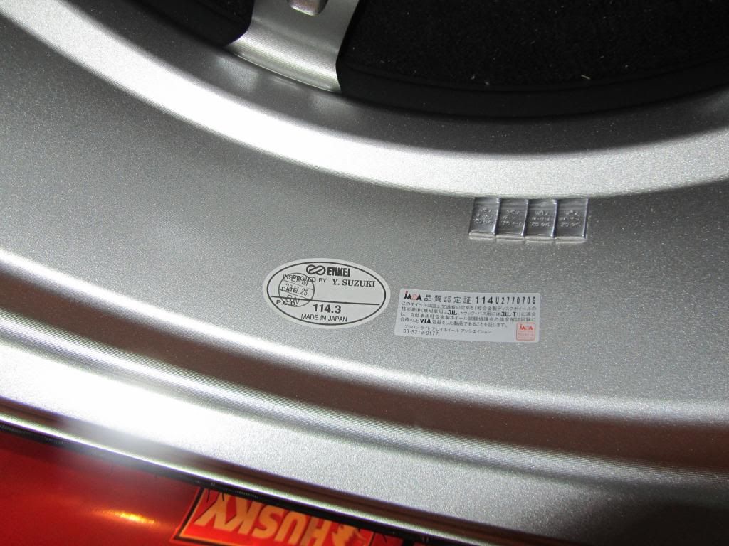

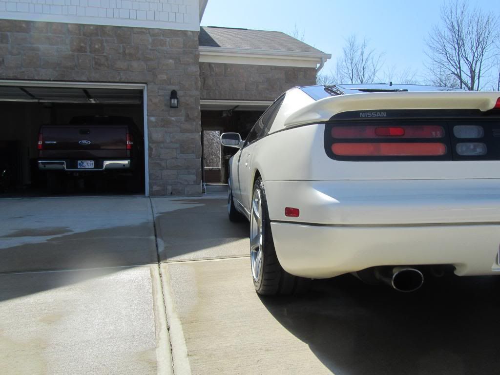

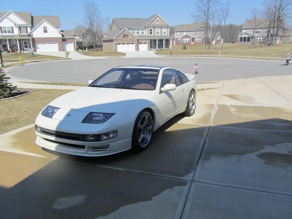

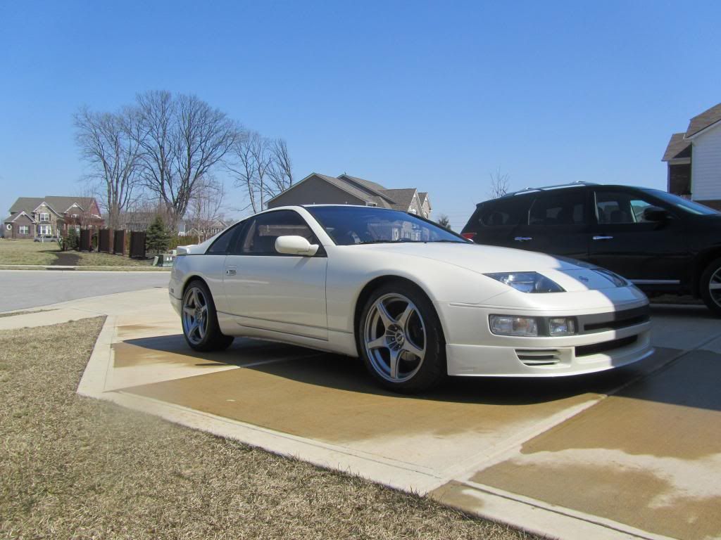

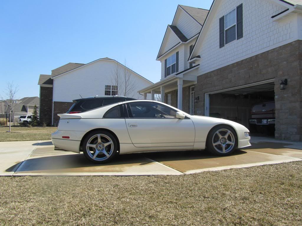

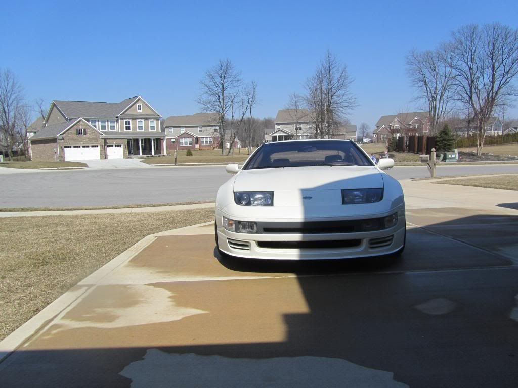

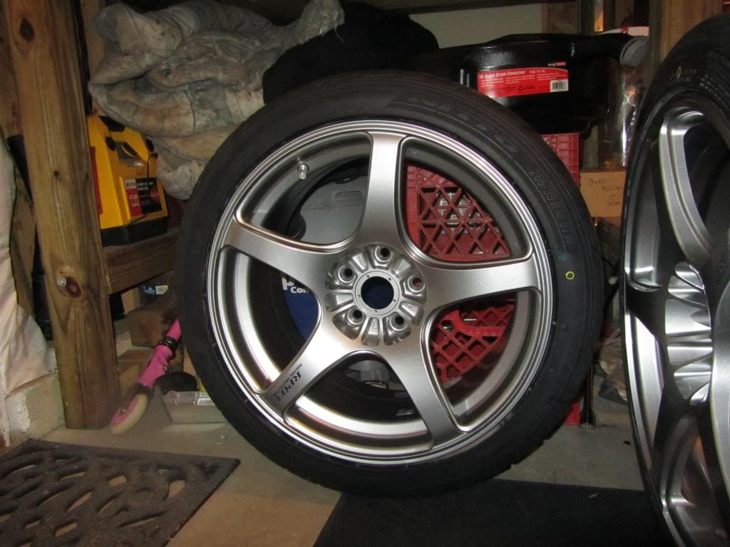

There is an option with these wheels to get the SBC (special brilliant coating) that resembles chrome plating. However, my car is pearl white (KH4) and I personally think a chrome wheel doesn't match up well with this color. Therefore, I went with the silver paint. They look awesome! So here are the pics.

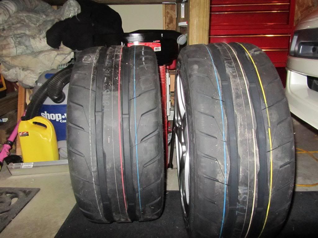

Comments on the tires:
These tires look awesome. They are a soft compount meant to grip the road, and they did not disappoint me. I was spinning through 1st and second gears all the time last Fall. This was especially true during colder temps. I took the car out for the first time with my new wheels and tires yesterday, and the Nitto's hooked up very nicely. It was only about 40 to 45 degrees outside, and I still had grip under 16.5 lbs of boost (tires were warmed up). That was the first time I've really been able to enjoy the power through the gears since I got it dyno-tuned last Spring by Greg and Seb. It was a great feeling.
